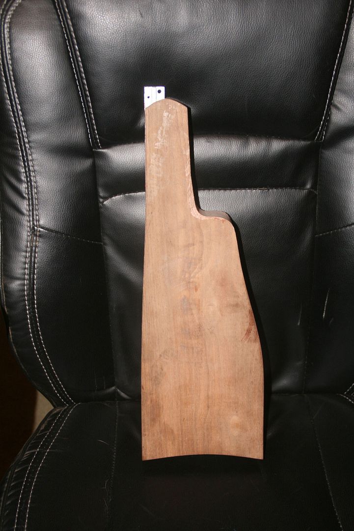

did some doodling the last couple of days and tonight we cut out another piece of wood I think this one will work I put enough meat into it in the places that it needs it so I can cut it to fit as I whittle on it.
I know it looks a little chunky, but I'm not a designer of stocks, but I think it will clean up pretty nice and get it to fit my long arms.

What is that? Cherry?
R
Rasper wrote:What is that? Cherry?
R
black walnut

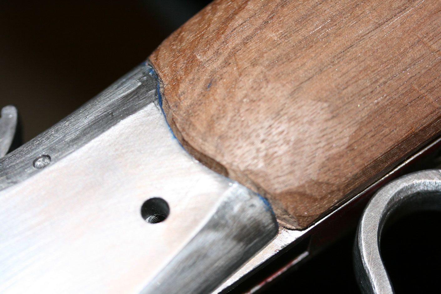

headache finally let up so I decided to work on the stock some more, this joint really has to be done before anything else so one little chip at a time I'm getting it done.
Painted the receiver with some water based layout marker and tap the stock into place then take a wood chisel and shave off the marked places hoping for full contact.

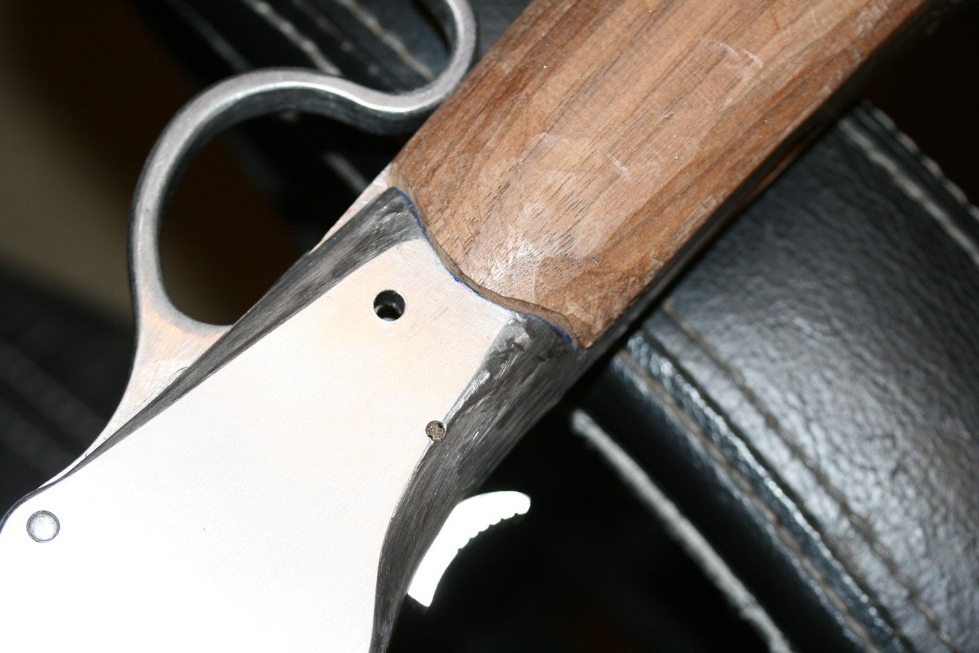

Anyway here's a shot of each side, I still have a ways to go before the joint is done, it can't be seen in the photos but I let the bottom tang into the stock last night and now not only have to get full contact in the joint ( the shape of the joint causes the recoil to tighten the joint up when the rifle is fired) but also have to get the Lower Tang Screw holes to line up. You can just barely see the misalignment in the holes in the first photo.
The other side
Are you whittling it all or do you have a draw knife? Walnut is tough.
Jammer wrote:Are you whittling it all or do you have a draw knife? Walnut is tough.
not quite whittling it but close,

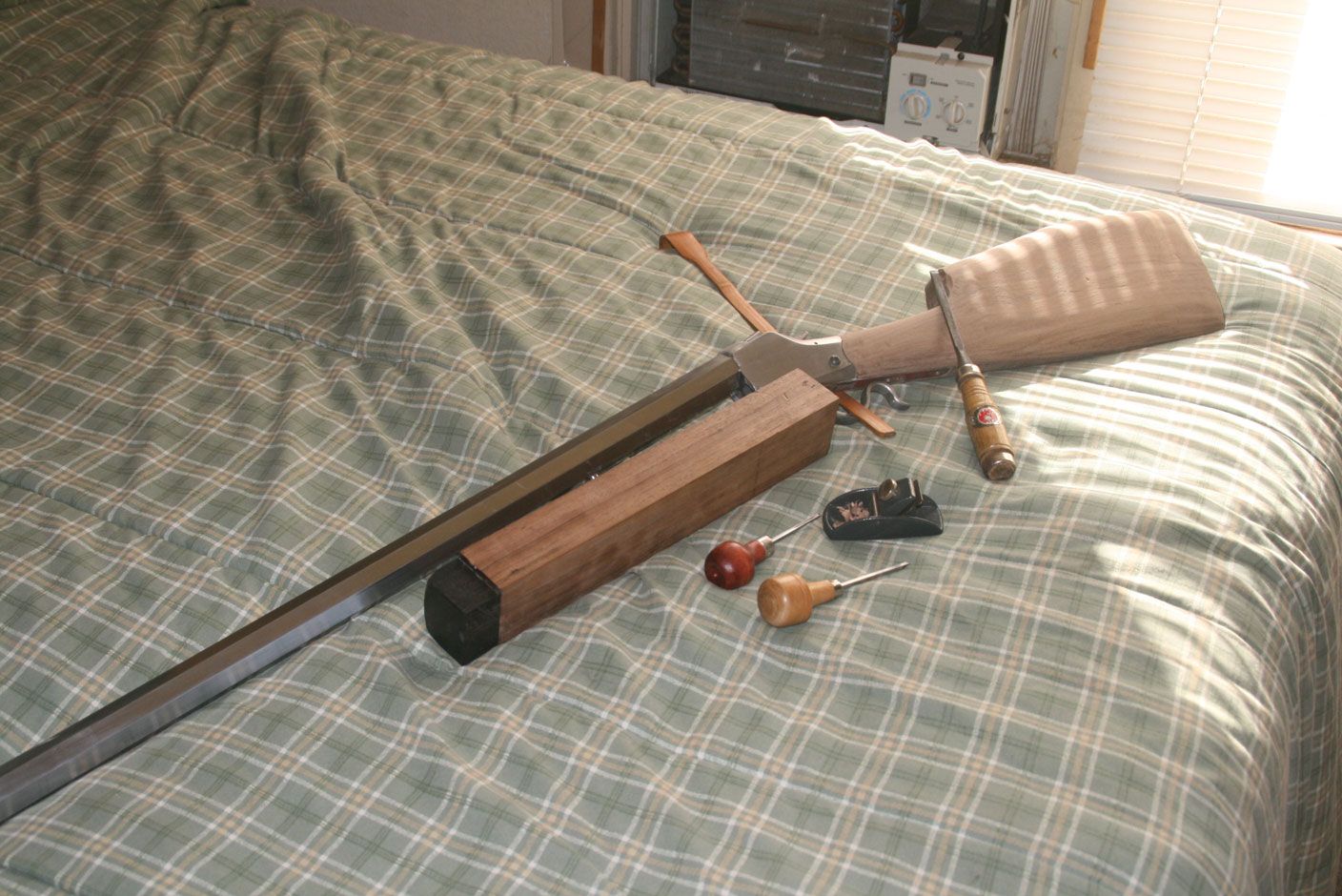

Jerry here's a shot that shows about 1.3 of my wood working tools
need to find or make me a really small draw knife so I can work the curves on the chime my spoke shave won't fit in, also need to rework the gouge that I made yesterday so its rounder and has more taper in it.
I need a couple small planes and a smaller draw knife. I've got a chunk of walnut from the woods where I grew up. I've hauled it around for over 30 years and it had been cut 30 years before that so it should be well seasoned. :P
